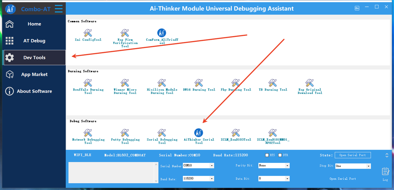

🔹Serial Assistant Download
Use the debugging tool to install the serial assistant, as shown below:

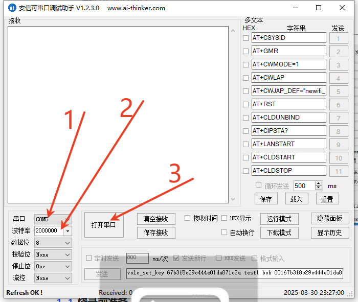

🔹Select Serial Port and Baud Rate
  • Select the corresponding COM port
  • Select baud rate: 2000000
As shown below:

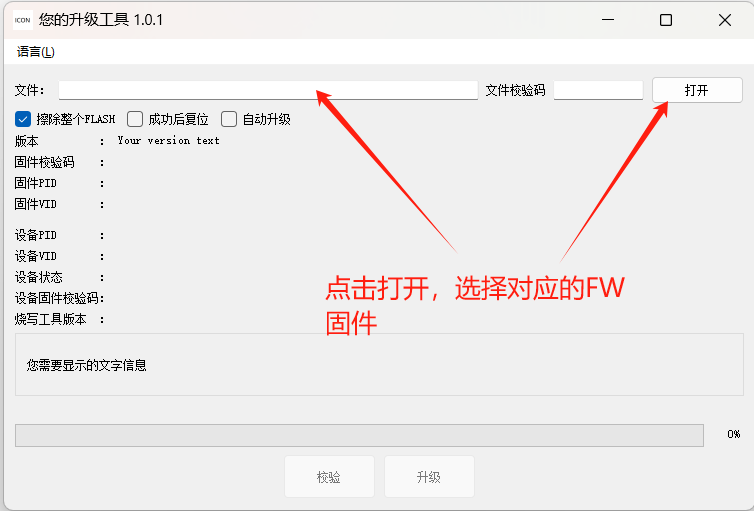

  • (1). First open the flashing software as shown below:
alt text

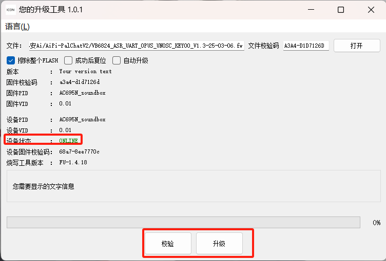

After connecting the flasher and powering on, the red light stays on, the green light blinks, and when you press the button on the flasher, the green light turns off. At the same time, the device status in the upper computer changes to ONLINE, and the "Verify" and "Upgrade" buttons become active.
As shown below:
alt text
  • (2). Click "Upgrade" to complete the flashing.
