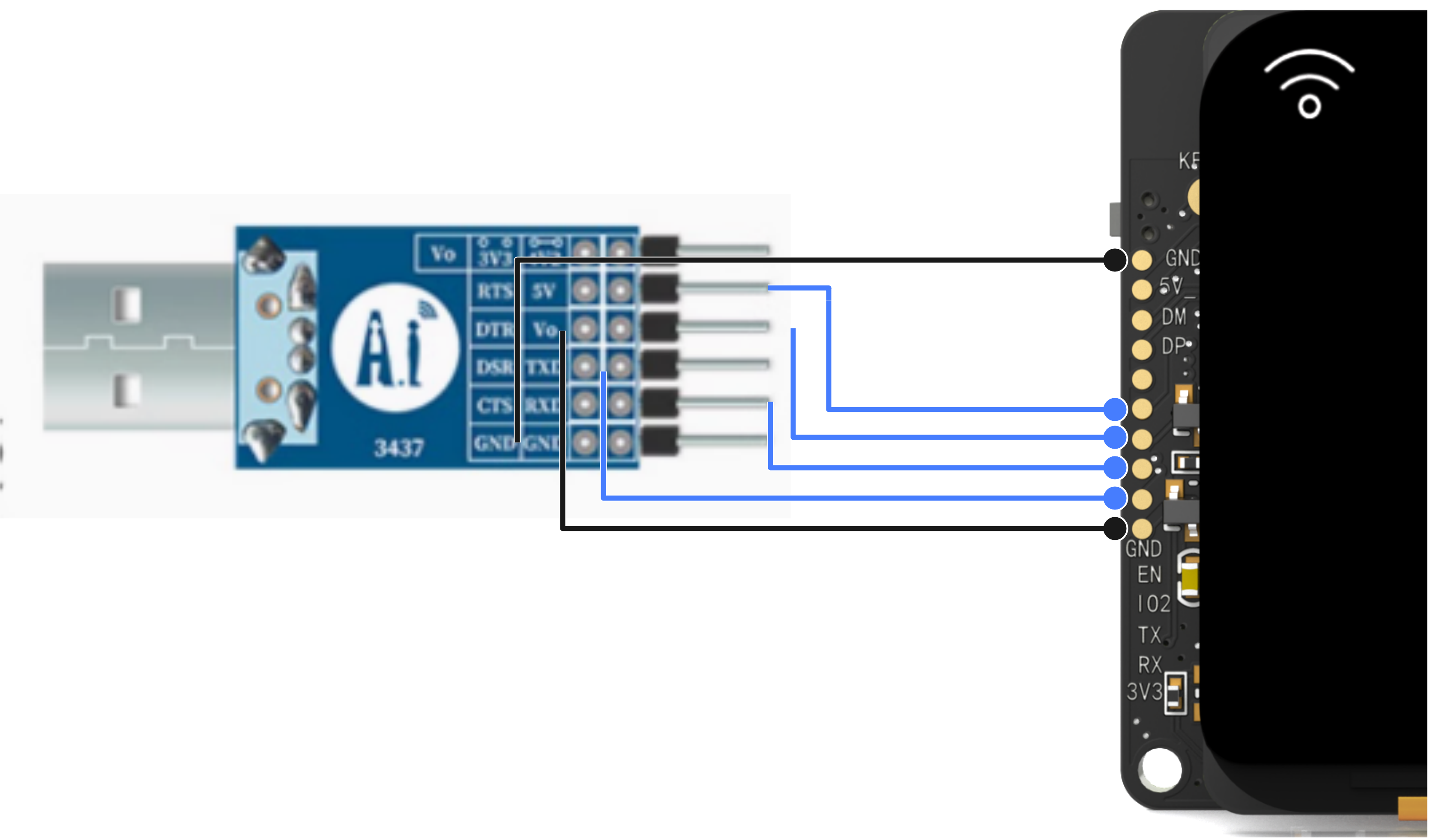

🔹Wiring
  • V1.0 version wiring
TTL to USB ModuleAiPi-PalChatV2_V1.0
GNDGND
TXDRX
RXDTX
Vo3V3
DTRIO2
RTSEN

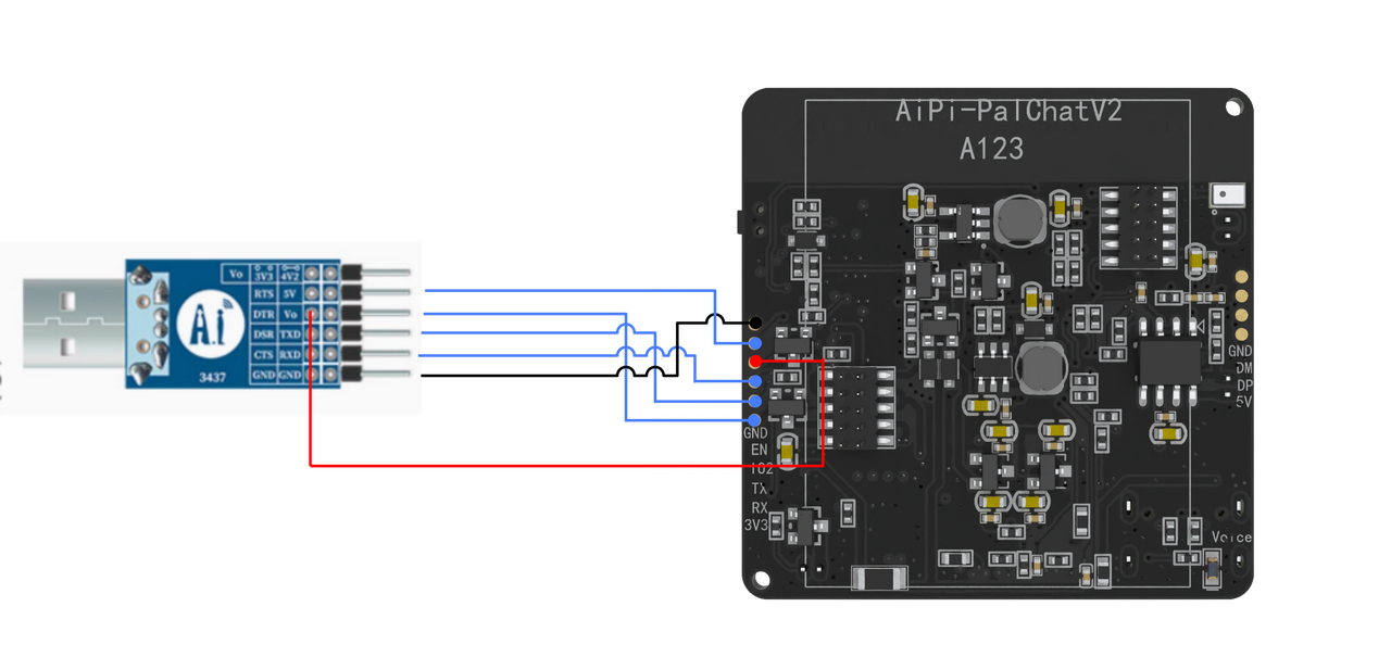

  • V2.0 version wiring
TTL to USB ModuleAiPi-PalChatV2_V2.0
GNDGND
TXDRX
RXDTX
Vo3V3
DTRIO2
RTSEN
Dimension diagram

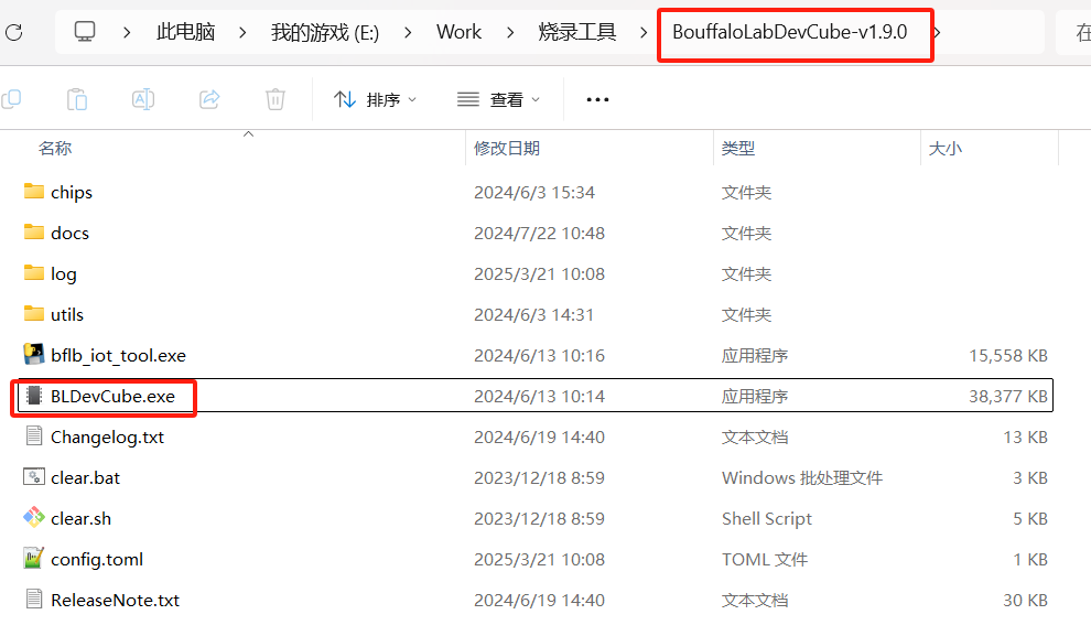

  • Double-click the BLDevCube.exe software, as shown below:
Click to view
alt text

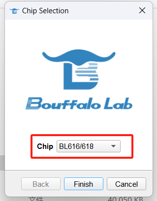

  • Select the BL616/618 chip, as shown below, and click OK:
Click to view
alt text

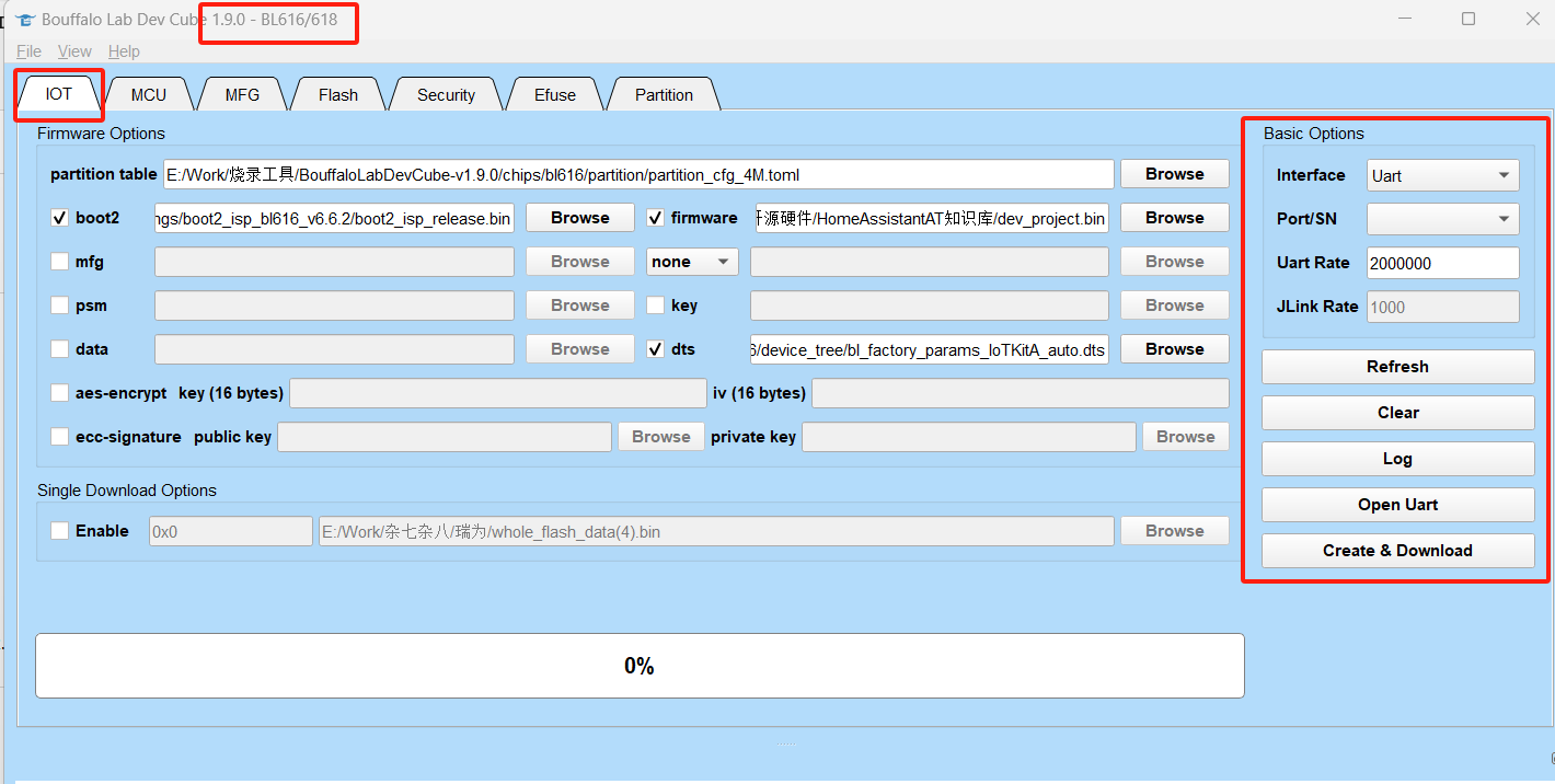

  • Select the IOT download mode
Select Uart on the right interface
If you use the CP2102 purchased from Ai-Thinker Taobao store, select baud rate 921600. If you have an FT232 chip, you can select 2000000. The development board serial chip is 340C, you can also select 2000000.
Click to view
alt text

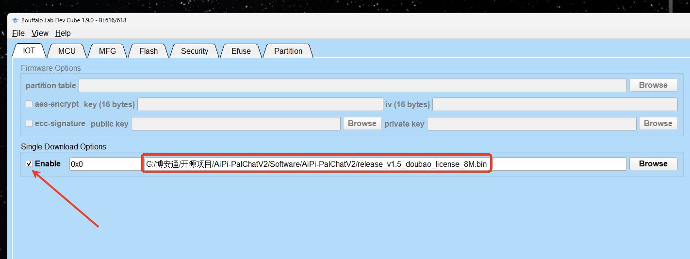

  • Enable composite firmware and select the firmware, as shown below:
Click to view
alt text
